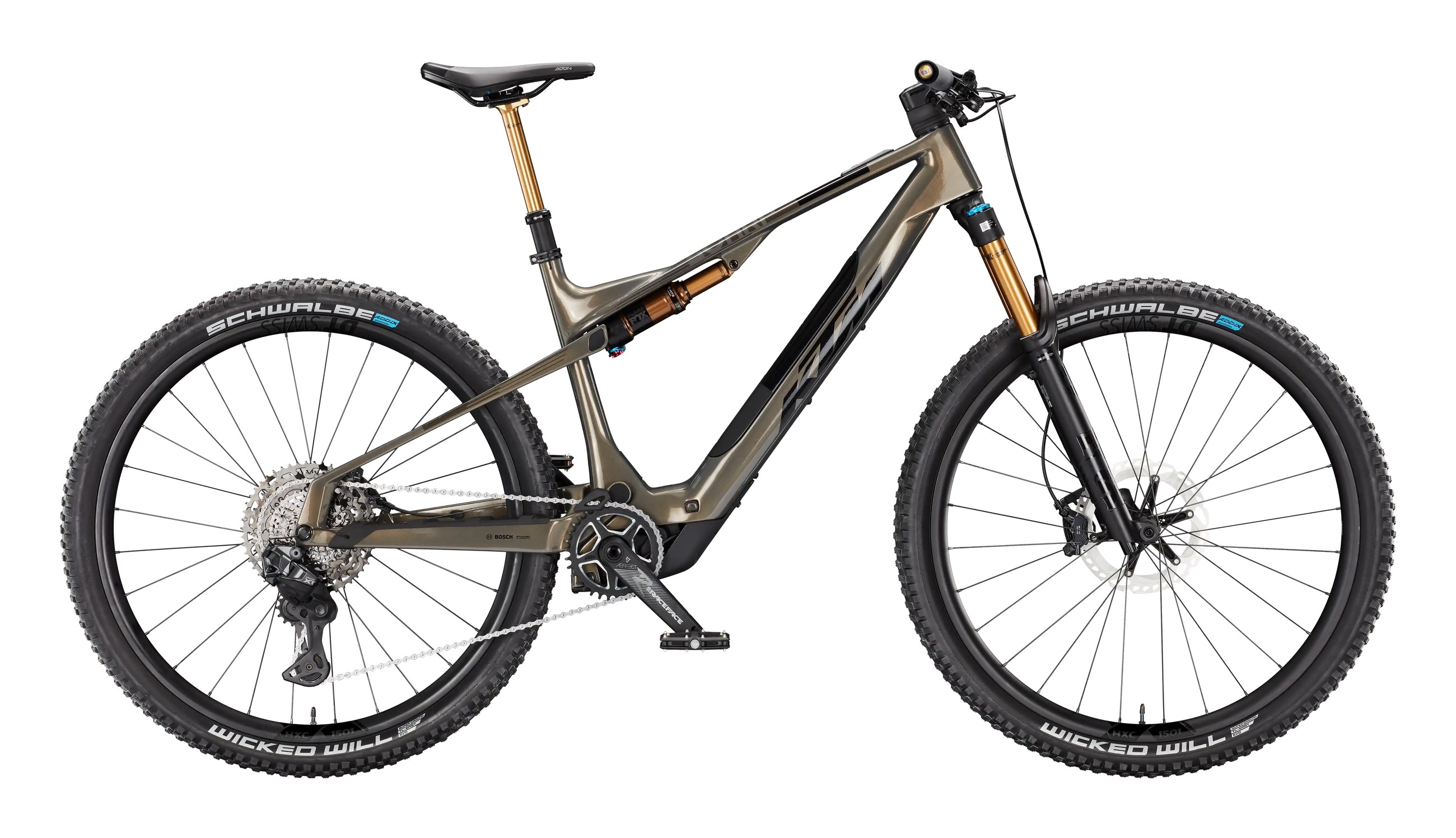

Nimble 17.3kg trail bike with the natural feel of a lighter drive
Motor
Bosch Performance Line SX · 55Nm · 600W
Battery
Bosch CompactTube 400 · 400Wh
Travel F/R
140/140mm
Wheels
29F / 29R
Frame
Full carbon
Weight
17.3 kg
Price
From £4,240
View the KTM Macina Scarp SX on KTM’s site
KTM Macina Scarp SX 2026
From £4,240
EMTB Forums verdict
The Macina Scarp SX is KTM's lightweight trail e-MTB, built on the carbon Scarp race fully platform and powered by Bosch's compact Performance Line SX motor. With 140mm of travel front and rear, 29in wheels and a frame-mounted CompactTube 400Wh battery that lifts out from the top of the down tube, it sits firmly in the light-assist category rather than the full-fat power class. The geometry is moderate for the segment: a 66.0 degree head angle, 76.5 degree effective seat angle and reach that runs 456mm on the M, 472mm on the L and 499mm on the XL, with chainstays held at 451mm across all three sizes.
The five-trim range is a clear price-led ladder. The Elite is the value entry, the only build with a RockShox Recon Gold fork and a mechanical Shimano Deore XT mix, and at 20.2kg it is the heaviest here. Stepping up, the Master DI2 and Prestige DI2 move to wireless Shimano Di2 shifting and Fox suspension, while the Prime brings SRAM GX Transmission with KTM's own carbon wheels. The flagship Exonic is the lightest at a claimed 17.3kg and the most thoroughly specced, pairing SRAM XX Transmission, Fox Factory suspension, a wireless Fox Transfer NEO dropper and an integrated FSA carbon cockpit.
Battery capacity is fixed at 400Wh across the line, so range buyers should note the option of the Bosch PowerMore 250Wh range extender, which mounts on the battery cover. The price spread is wide, running from 4,899 to 9,699 euros, so the choice largely comes down to how much weight saving and electronic shifting are worth to you, since the frame, motor, battery and geometry are shared throughout.

How it stacks up vs other Lightweight · Trail bikes (from 93 bikes in the database)
Weight17.3 kg1.6 kg lighter than average
Battery400 Whabout average capacity
Motor torque55 Nmabout average torque
Value for moneyExceptional value97/100 · from £4,240 vs ~£5,499 for typical Bosch Performance Line SX bikes — undercuts typical price; current-gen
Bike geometry diagram
MLXLL (48)M (43)XL (53)
Reach456 mm472 mm499 mm472 mm456 mm499 mm
Stack601 mm615 mm629 mm615 mm601 mm629 mm
Seattube430 mm450 mm480 mm450 mm430 mm480 mm
Chainstay451 mm451 mm451 mm451 mm451 mm451 mm
Headtube Angle66°66°66°66°66°66°
Seattube Angle (eff)76.5°76.5°76.5°76.5°76.5°76.5°
BB Drop30 mm30 mm30 mm
Wheelbase1208 mm1231 mm1264 mm1231 mm1208 mm1264 mm
Headtube90 mm105 mm120 mm
Standover809 mm817 mm825 mm817 mm809 mm825 mm
Front Centre757 mm*780 mm*813 mm*780 mm*757 mm*813 mm*
FC:RC1.681.731.801.731.681.80
